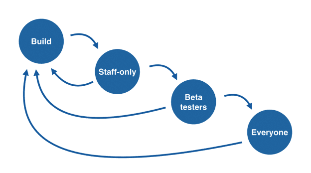

It’s not the only thing that helps us move quick. We test relentlessly on ourselves, so feature flagging is a regular part of how we build product. We’ll release to ourselves first, then to a select group of customers and then roll it out to our customers. It means we get early feedback into whether something’s going to work or not.
