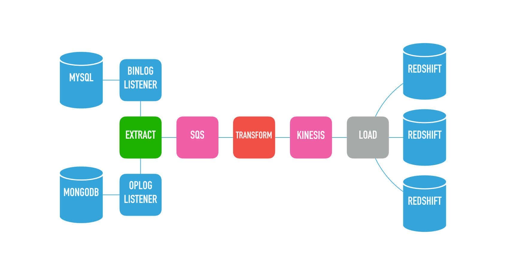

But it wore thin after a while, and I was exhausted. We decided to replace it with something more exciting for our customers, but more boring for us to own. I jumped straight in, wanting to show off as usual. I came up with this:
This was before any design or research was done. We have listeners passing data into a hand-rolled, artisanal ETL pipeline and loading data in through our fleet of Redshift clusters. I stood back and was like, “Yeah, I think I’m done here. I can’t think of any more ways to show off. This is done.”
But this is nuts. It would have taken ages to build, been a nightmare to own and cost us a ton of money to run every month. I was repeating the same mistakes I’d been making before. I wanted to set out and fix those mistakes that I was making.

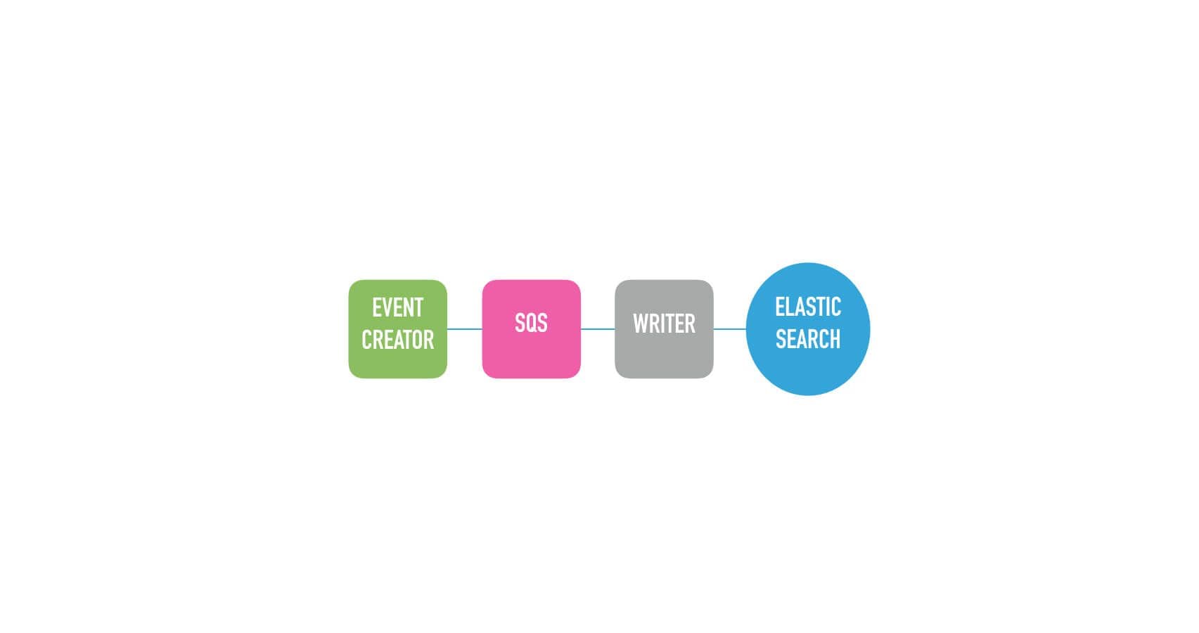

If you have a technology already in your stack, you probably have really good answers for these already, because we don’t want to keep answering the same questions again. We use Elasticsearch quite a lot at Intercom, so I decided to ask the question, “Could I use existing tech that we have to solve the problem that I’m looking at?”
Compared with Redshift, Elasticsearch was much better suited for our use case. I didn’t have to answer all these questions again, and it knocked a lot of time off. I could just get on with building a solution. Now, with our boring Elasticsearch data store, we got rid of this fleet of Redshift clusters. We don’t need a load node anymore. We can just have a simple writer. We went with a much simpler event-based approach, so now we don’t need a whole ETL pipeline, and we end up with this simple architecture diagram.

What did boring get us in the end? We estimated about six months build time for the original design, and it ended up taking us just six weeks. It was going to cost us $70,000 a month to own, and now it’s just $5,000. We were able to get a lot more engineers on board and really speed up development, and most importantly, I got some rest, which was good.
