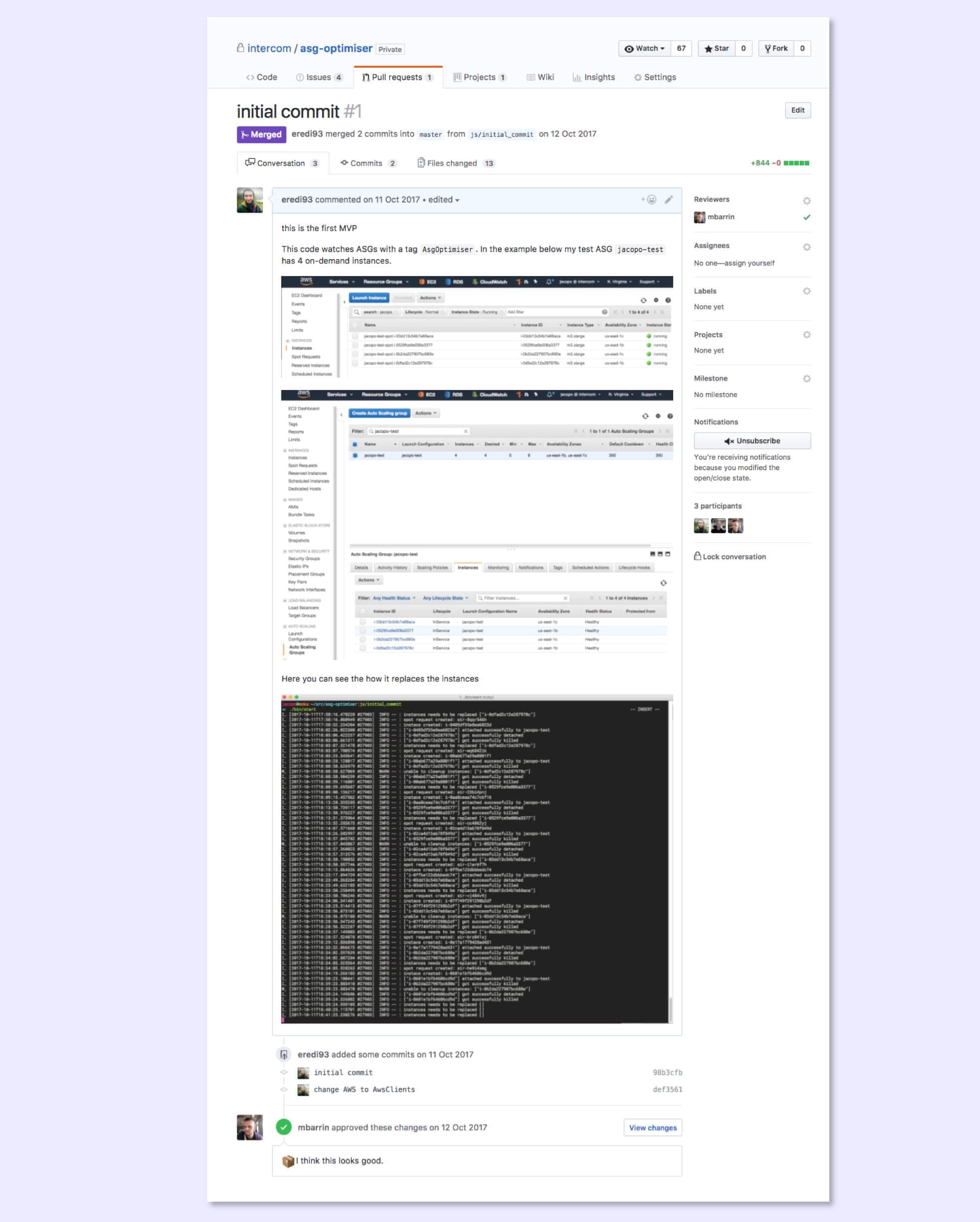

By the end of the week I had a single process that was synchronously watching my ASG, taking an On-Demand instance, made a copy of it and swapped them once it passed the EC2 checks. Here’s what my initial commit looked like:

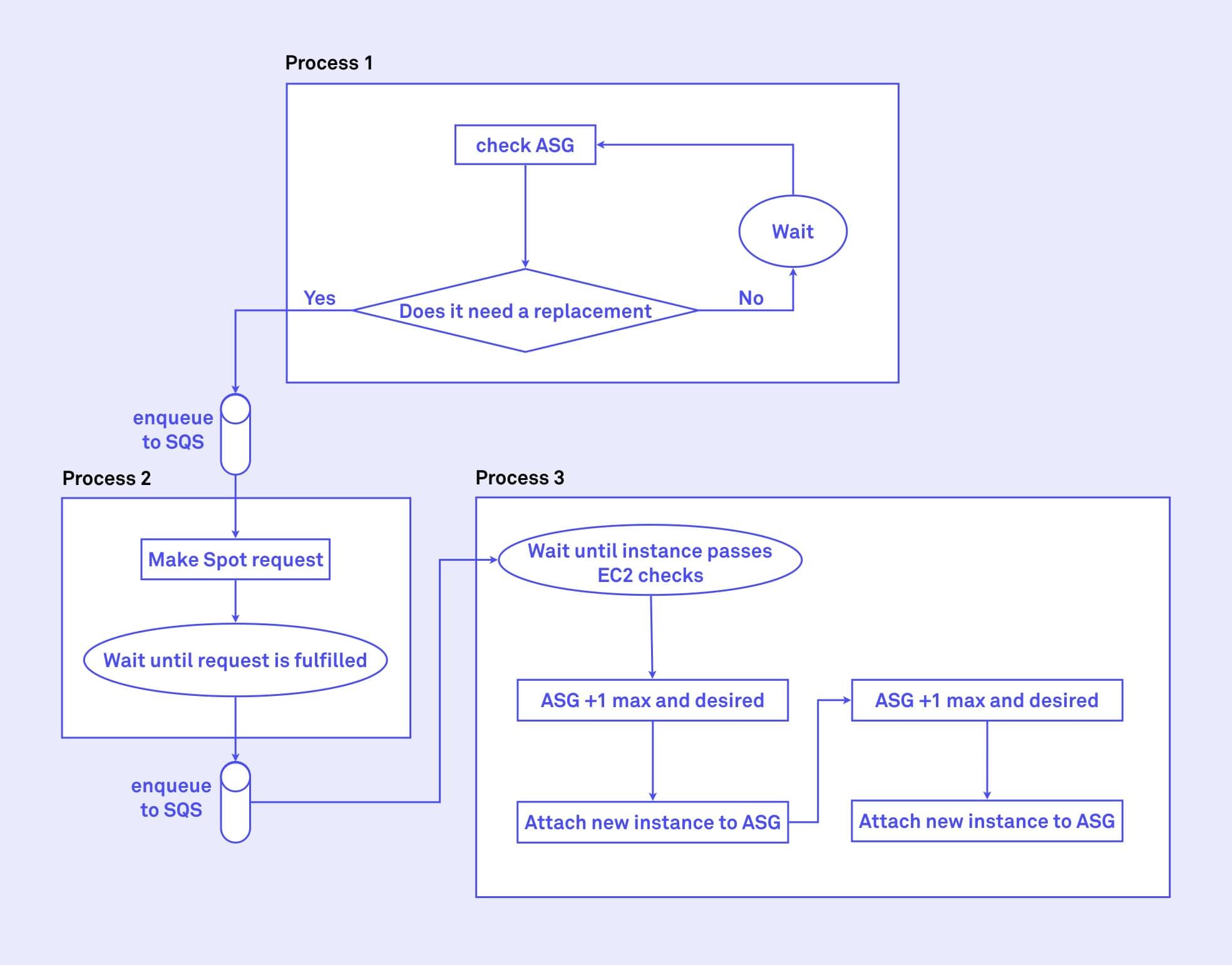

In order to make the ASG-optimizer production ready, the next step was to fix the biggest pain point with the proof-of-concept: scalability. With the initial commit, I could only replace one of thousands of our hosts per minute. That just doesn’t work for an infrastructure of Intercom’s size. So I moved the ASG-optimizer to an asynchronous model and used SQS to split the single-process into three processes:
- Process 1 monitored all Auto Scaling Groups with the tag “AsgOptimiser” and add any replacement candidate to a ‘Spot Instance Creator’ SQS queue.
- Process 2 polled the ‘Spot Instance Creator’ queue, created a Spot Instance, then added [new Spot Instance ID, old On-Demand Instance ID] to the ‘Instance Swapper’ SQS queue.
- Process 3 polled the ‘Instance Swapper’ SQS queue, waited until the Spot Instance passed EC2 checks, swapped the instances, and terminated the old On-Demand Instance.

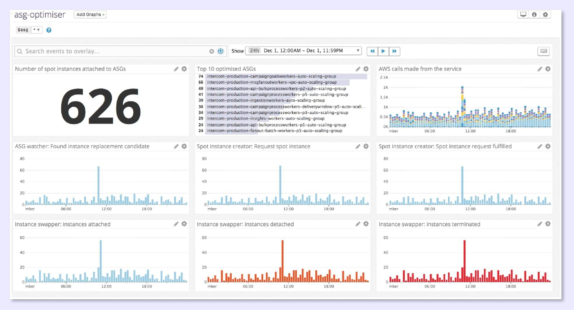

At the end of the second week I deployed the new asynchronous service to production, optimizing a single Auto Scaling Group, prepared a rollout plan for my team and came back to Dublin. Then on the following Monday morning, I shipped it for all our near-realtime clusters and learned that it needed another bit of work, such as reducing the number of API calls to AWS and introducing orphan-instance cleanup.
ASG-optimizer was now enabled for about 140 Auto Scaling Groups replacing about 650 instances every day. This would halve our EC2 bill over time.
