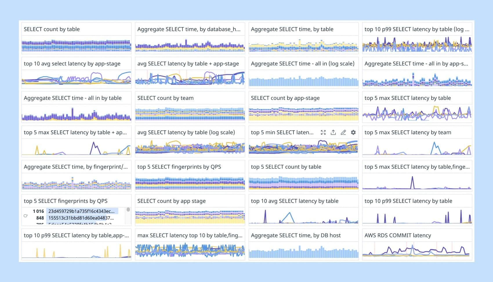

Armed with our own definition of observability, we assessed our existing practices and formulated a problem statement. Until recently, our observability tooling has been primarily based on metrics. A typical workflow involved looking at a dashboard full of charts with metrics sliced and diced by various attribute combinations. Folks would look for correlations, but often leave without fulfilling insights.
“Metrics are easy to add and understand, but they are missing high-cardinality attributes (e.g. Customer ID), making it difficult to complete an investigation”
Metrics are easy to add and understand, but they are missing high-cardinality attributes (e.g. Customer ID), making it difficult to complete an investigation. Previously, a handful of observability champions would continue the workflow using secondary tools (e.g. logs, exceptions, etc), trying to access the high-cardinality information and build a fuller picture. That skill required constant practice – an unrealistic ask for the majority of product engineers who are busy delivering product.
We identified this lack of consolidated observability experience as a problem to be solved. We wanted it to be easy for anyone to ask an arbitrary question about production and get insights without having to master a set of disconnected, undersetuped, and pricy tools. To mitigate the problem we decided to double down on tracing telemetry.
A typical operational dashboard we used before doubling down on traces

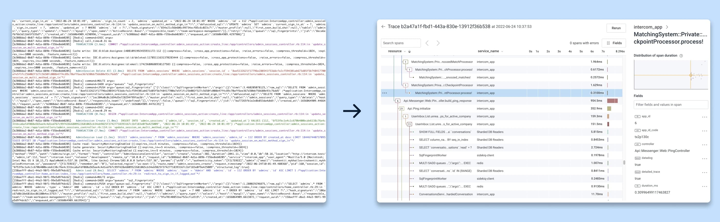

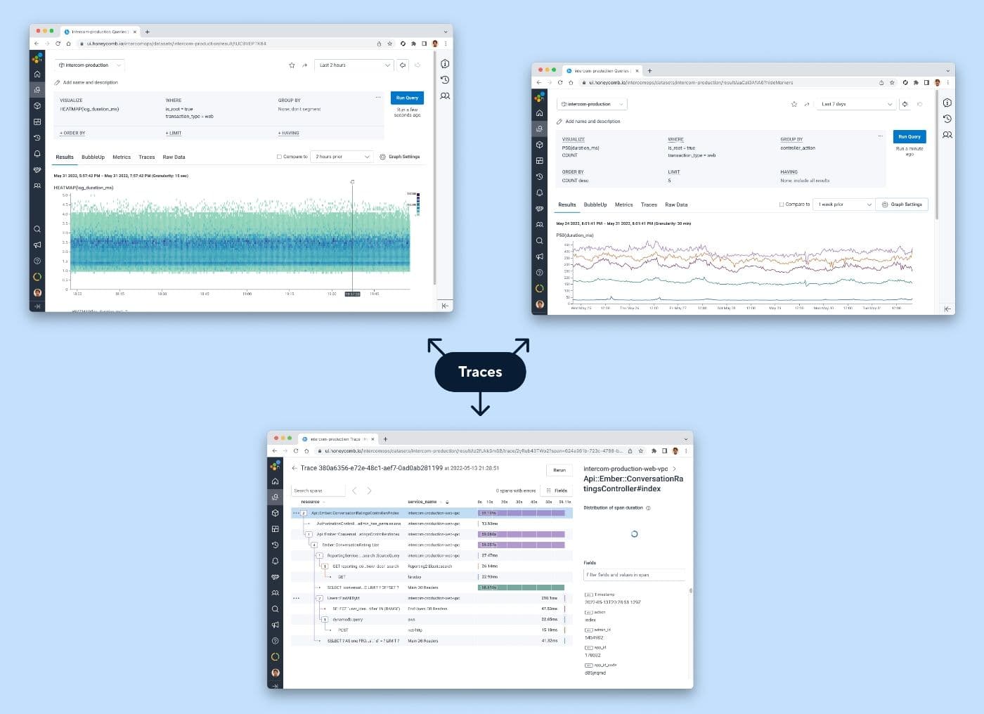

Why traces?
Any observability tool is just a tool with a human behind it – and humans need good visualizations. It doesn’t matter what kind of data powers the visualization, just that the tool allows you to seamlessly switch between different visualizations and get alternative perspectives on the problem.
Traces have a massive advantage over other telemetry data – they encode enough information about transactions to power virtually any visualization. Building observability workflows on top of traces ensures a smooth consolidated experience without the need to switch the underlying data or the tool.
Some of the types of visualizations that can be powered by traces

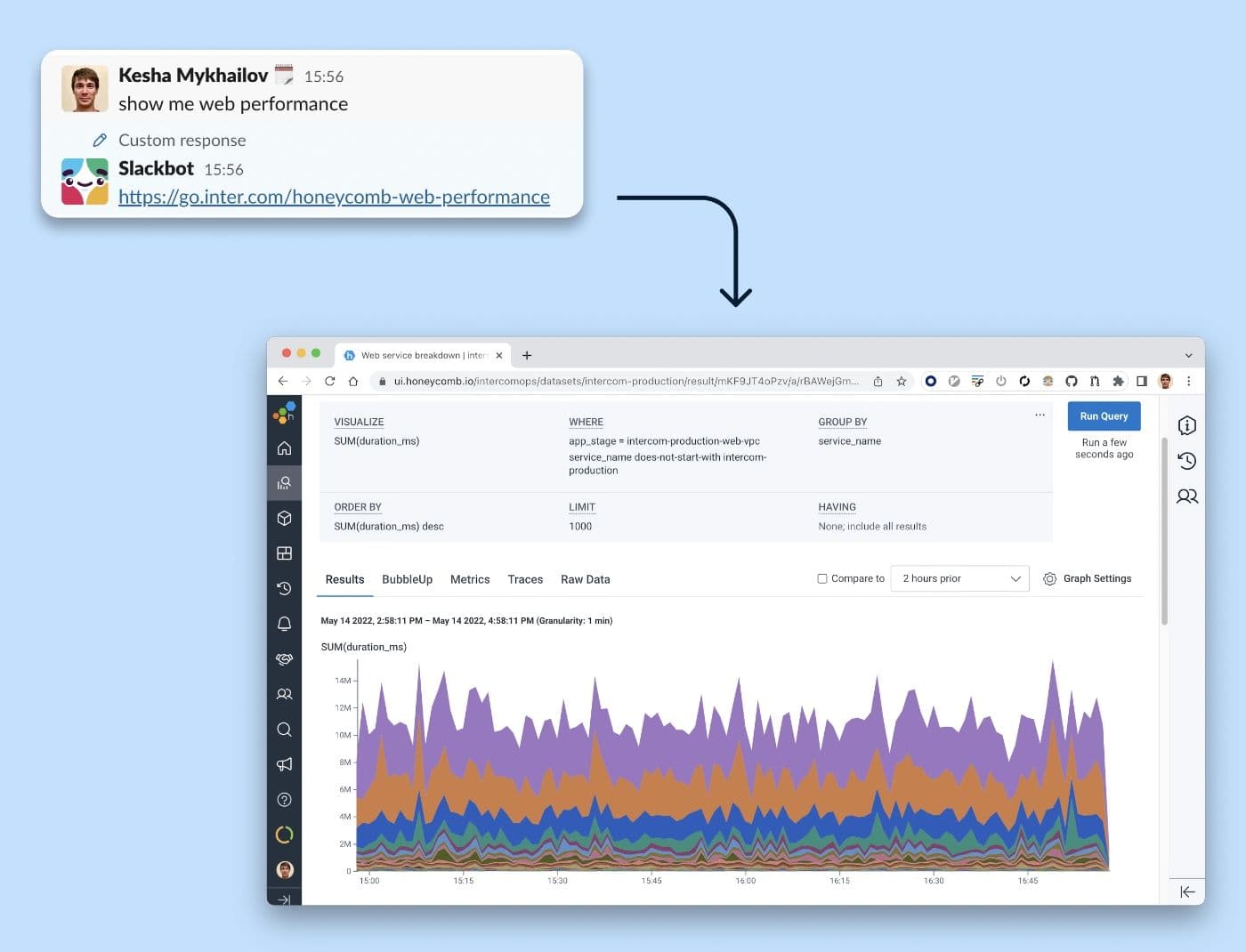

Slackbot query shortcuts
When production is in trouble the last thing you want is to have to scramble for the right query. We added a custom bot reaction to a “show me web performance” message. Following the Slackbot link opens up a web endpoints performance broken down by service.
We streamline our observability workflow with a Slackbot that provides a shortcut to a popular query within our observability tooling

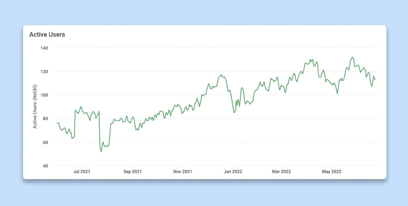

Measuring adoption
Measuring return-of-investment (ROI) on observability tooling is challenging. Tracking the number of active users is a good indicator of how often engineers engage with the tooling, and we benefited a lot from Honeycomb’s usage metrics.
This chart shows the increase in the number of active Honeycomb users since observability enablement began

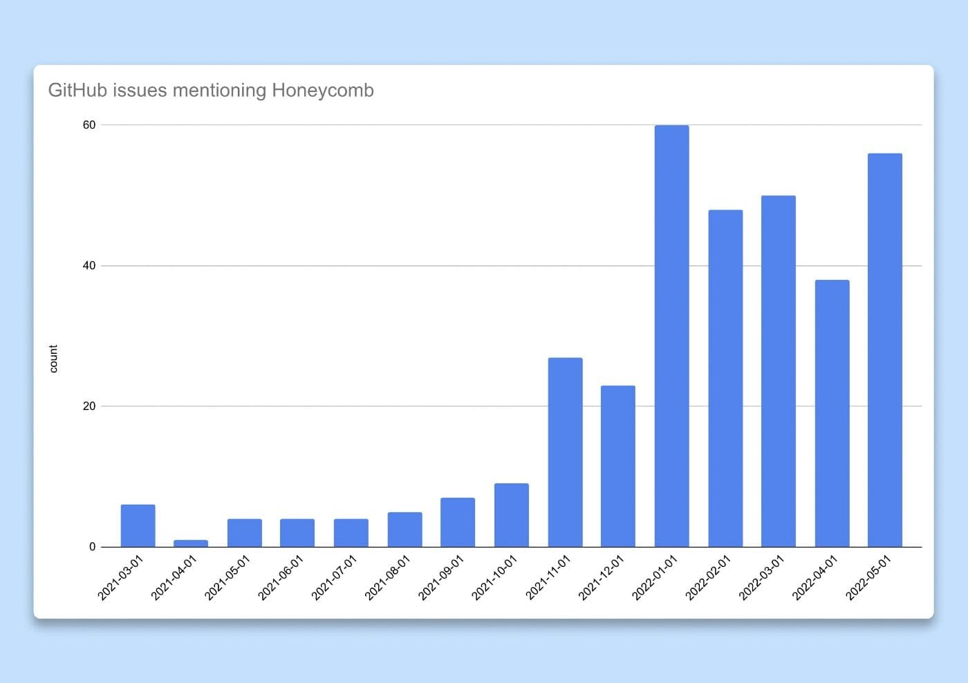

We went further and measured the usefulness of those engagements. We postulated that if insights gained from the observability tooling were valuable, people would share them with their peers. Our engineering workflows heavily depend on Github issues so we decided to count the number of issues or pull requests where Honeycomb was mentioned or linked to (trace, query result, etc.) as a proxy for an adoption metric. As we doubled down on enablement towards the end of 2021, we observed an explosion in the number of issues mentioning Honeycomb, proving that we were on the right track.
Bar chart showing the number of GitHub issues where Honeycomb is mentioned in the title or description
